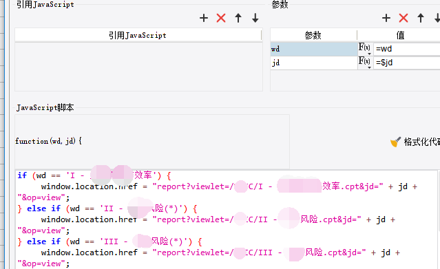

JS实现链接打开于对话框
现有一张雷达图,为了实现点击每个点,跳转链接到对应的每个不同详细页面,使用了中间表写js的方式,打开的是新页面,现在需要改为打开的链接于对话框。
求教大神!!!在线等!!!急!!!!
现在改为了
if (wd == 'I - 效率') {
FR.doHyperlink(window.event, [{
 "data": "var as=arguments; return FR.tc(function(){FR.doHyperlinkByGet4Reportlet({\"para\":{\"__pi__\":true},\"feature\":\"width=1000,height=320,\",\"title\":\"I - 效率\",\"url\":\"/webroot/decision/view/report?viewlet=/MS/I - 效率.cpt&op=view\",\"target\":\"_dialog\"})}, this, as)",
 "name": "I - 效率"
}], true)}
结果是跳到这张写加载事件的空cpt页面上展示出了对话框,需要的结果是在雷达图所在frm页面点击雷达图点后直接展示对话框

29831048Lv0见习互助
发布于2019-7-22 18:00
var iframe = $("<iframe id='001' name='001' width='100%' height='100%' scrolling='yes' frameborder='0'>") // iframe参数的命名及宽高等
if (wd == '纬度1') {    //判断点击到的点,根据所选纬度弹出明细对话框
    iframe.attr("src", "report?viewlet=/test/明细1.cpt&op=view&jd=" + jd + "")
} else if (wd == '纬度2') {
    iframe.attr("src", "report?viewlet=/test/明细2.cpt&op=view&jd=" + jd + "")
} else if (wd == '纬度3') {
    iframe.attr("src", "report?viewlet=/test/明细3.cpt&op=view&jd=" + jd + "")
} else if (wd == '纬度4') {
    iframe.attr("src", "report?viewlet=/test/明细4.cpt&op=view&jd=" + jd + "")
} else if (wd == '纬度5') {
    iframe.attr("src", "report?viewlet=/test/明细5.cpt&op=view&jd=" + jd + "")
} else if (wd == '纬度6') {
    iframe.attr("src", "report?viewlet=/test/明细6.cpt&op=view&jd=" + jd + "")
} else if (wd == '纬度7') {
    iframe.attr("src", "report?viewlet=/test/明细7.cpt&op=view&jd=" + jd + "")
} else if (wd == '纬度8') {
    iframe.attr("src", "report?viewlet=/test/明细8.cpt&op=view&jd=" + jd + "")
} else if (wd == '纬度9') {
    iframe.attr("src", "report?viewlet=/test/明细9.cpt&op=view&jd=" + jd + "")
var o = {
    title: wd,    //对话框标题(这里取雷达图纬度名作弹出框标题)
    width: 1265,  //宽
    height: 370  //高
FR.showDialog(o.title, o.width, o.height, iframe, o) //弹出对话框

FR.showIframeDialog({
url:"ReportServer?reportlet=wljcxx_pldr.cpt&op=write",
title:"物料基础信息批量导入",
width:670,
height:610
用这一句
  • a-pity a-pity(提问者) 有多个页面 ,怎么拼接进去
    2019-07-18 13:56
  • Kevin-s Kevin-s 回复 a-pity(提问者) FR.doHyperlinkByGet4Reportlet({\"para\":{\"__pi__\":true},\"feature\":\"width=600,height=400,\",\"title\":\"网络报表1\",\"url\":\"/webroot/decision/view/report?viewlet=%2FGettingStarted.cpt\",\"target\":\"_dialog\"}),要不然你把window。location。href替换成这个,跟你的比较类似
    2019-07-18 14:45
  • Kevin-s Kevin-s 回复 a-pity(提问者) 记得\\要去掉。可以记得采纳
    2019-07-18 14:47
  • a-pity a-pity(提问者) 回复 Kevin-s 用不了啊 目前做的是: Frm里面一张雷达图,雷达图链接到的网络报表是 只写加载事件的 cpt页面,参数wd指的是取雷达图点信息,这样预览点击雷达图点时,明细在新页面展示 要的效果是点击雷达图点,详细页直接以对话框展示在当前Frm页,不需要那张加载事件的控cpt了 完善了一下问题 麻烦看下🙇🙇‍🙇‍🙇‍🙇‍‍
    2019-07-18 15:24
  • Kevin-s Kevin-s 回复 a-pity(提问者) 这还是以前的问题么笑哭
    2019-07-18 17:00
zy_20180110Lv5中级互助
发布于2019-7-18 15:36
var url = "";
var title = ""
var o = ""
if(flag=="值1"){
url = "链接地址";
title = "标题";
o = {
width : 580,  //对话框宽度
height: 290  //对话框高度
}else if(flag=="值2"){
url = "链接地址";
title = "标题";
o = {
width : 620,  //对话框宽度
height: 280  //对话框高度
var iframe = $("<iframe id='inp' name='inp' width='100%' height='100%' scrolling='yes' frameborder='0'>"); // 对话框内iframe参数的命名,默认宽高占比是100%,可向下滚动
iframe.attr("src", url); // 给iframe添加src属性
//弹出对话框
FR.showDialog(title, o.width, o.height, iframe,o);
  • a-pity a-pity(提问者) 你好!我目前做的是: Frm中雷达图特效→添加链接、网络报表 cpt→ 在这张cpt的web模板属性,加载结束事件中写的JavaScript,通过你这段代码实现了:点击雷达图点,跳转到cpt页,cpt页展示对话框。 但目前需要的是:点击雷达图点,直接在当前Frm页面展示对话框; 能否就是直接为图表添加JavaScript特效的方式实现效果
    2019-07-18 16:29
  • zy_20180110 zy_20180110 回复 a-pity(提问者) https://help.finereport.com/doc-view-622.html
    2019-07-19 08:20
