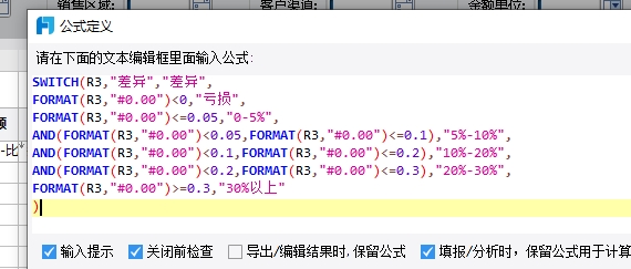

这公式有什么问题吗,模拟计算没有值
SWITCH(R3,"差异","差异",FORMAT(R3,"#0.00")<0,"亏损",FORMAT(R3,"#0.00")<=0.05,"0-5%",AND(FORMAT(R3,"#0.00")<0.05,FORMAT(R3,"#0.00")<=0.1),"5%-10%",AND(FORMAT(R3,"#0.00")<0.1,FORMAT(R3,"#0.00")<=0.2),"10%-20%",AND(FORMAT(R3,"#0.00")<0.2,FORMAT(R3,"#0.00")<=0.3),"20%-30%",FORMAT(R3,"#0.00")>=0.3,"30%以上")

公式呢
你把公式复制出来吧
if(R3="差异",R3,
SWITCH(true,
FORMAT(R3,"#0.00")<=0.1,"5%-10%",
FORMAT(R3,"#0.00")<=0.2,"10%-20%",
FORMAT(R3,"#0.00")<=0.3,"20%-30%",
FORMAT(R3,"#0.00")>=0.3,"30%以上"))
只用switch
SWITCH(true,R3="差异",R3,
用户k6280494Lv6专家互助
发布于2023-11-7 16:54(编辑于 2023-11-7 16:58)
switch(表达式, 值1, 结果1, 值2, 结果2, ...)
如果表达式的结果是值1,整个函数返回结果1
如果表达式的结果是值2,整个函数返回结果2
如果表达式的结果是值3,整个函数返回结果3
等等
switch(R3,'差异','差异')
表示r3=差异,为真结果就是差异,懂吗?

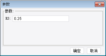

  • 0U8HGsVU 0U8HGsVU(提问者) 这个我知道,模拟计算输入差异,输出也是差异这个正确着呢,后面数据具体数字后就没有输出了
