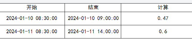

我有一个开始时间和结束时间,如果开始时间和结束时间大于0,就计算他们之间的时差,结束时间必须大于开始时间,然后有个规则,上午只按照3.5个小时计算,下午只按照4个小时计算;但是他们有一种请假的可能,比如上午请假半个小时或者一个小时,或者请假到下午2点,这个公式怎么样写,才能像下面一样获取到天数结果,求求大佬帮忙看看,写了三天了,一直不对image.png

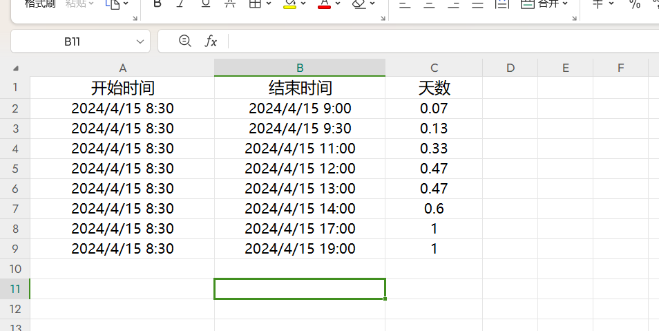

DATEDIF(B2,A2,"D") + round((if(REPLACE(RIGHT(A2,8),":","") * 1 <= 83000 && REPLACE(RIGHT(B2,8),":","") * 1 >= 173000,7.5,if(REPLACE(RIGHT(A2,8),":","") * 1 <= 83000 && REPLACE(RIGHT(B2,8),":","") * 1 <= 130000,3.5,if(REPLACE(RIGHT(A2,8),":","") * 1 >= 83000 && REPLACE(RIGHT(B2,8),":","") * 1 >= 130000,DATESUBDATE(CONCATENATE(left(B2,10)," 13:00:00"),A2,"s")/3600,4)))/7.5),2)

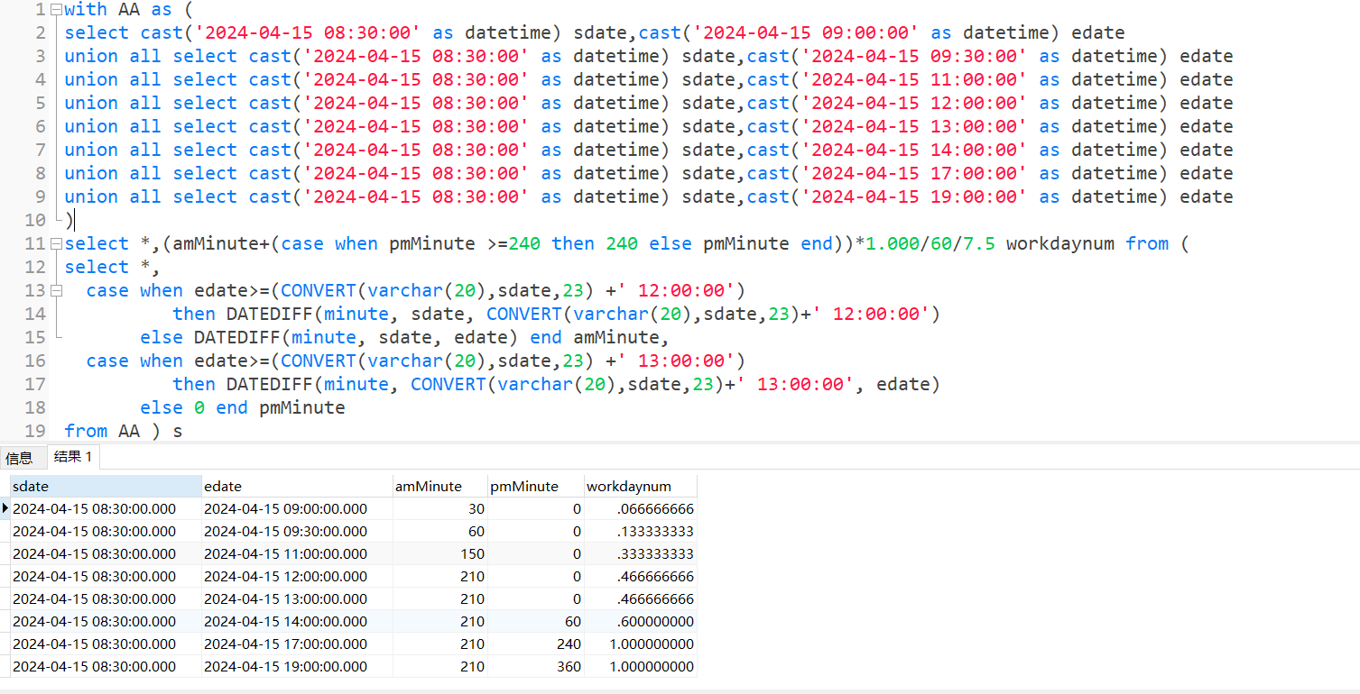

你这个挺麻烦的,在ds的sql里面处理吧
with AA as (
select cast('2024-04-15 08:30:00' as datetime) sdate,cast('2024-04-15 09:00:00' as datetime) edate
union all select cast('2024-04-15 08:30:00' as datetime) sdate,cast('2024-04-15 09:30:00' as datetime) edate
union all select cast('2024-04-15 08:30:00' as datetime) sdate,cast('2024-04-15 11:00:00' as datetime) edate
union all select cast('2024-04-15 08:30:00' as datetime) sdate,cast('2024-04-15 12:00:00' as datetime) edate
union all select cast('2024-04-15 08:30:00' as datetime) sdate,cast('2024-04-15 13:00:00' as datetime) edate
union all select cast('2024-04-15 08:30:00' as datetime) sdate,cast('2024-04-15 14:00:00' as datetime) edate
union all select cast('2024-04-15 08:30:00' as datetime) sdate,cast('2024-04-15 17:00:00' as datetime) edate
union all select cast('2024-04-15 08:30:00' as datetime) sdate,cast('2024-04-15 19:00:00' as datetime) edate
select *,(amMinute+(case when pmMinute >=240 then 240 else pmMinute end))*1.000/60/7.5 workdaynum from (
select *,
  case when edate>=(CONVERT(varchar(20),sdate,23) +' 12:00:00')
        then DATEDIFF(minute, sdate, CONVERT(varchar(20),sdate,23)+' 12:00:00')
else DATEDIFF(minute, sdate, edate) end amMinute,
case when edate>=(CONVERT(varchar(20),sdate,23) +' 13:00:00')
        then DATEDIFF(minute, CONVERT(varchar(20),sdate,23)+' 13:00:00', edate)
else 0 end pmMinute
from AA ) s
