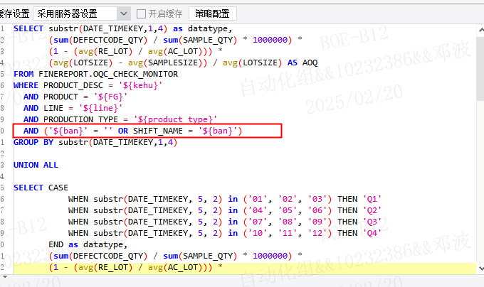

我想表达出当没有选择SHIFT_NAME参数时,获取PRODUCTION_TYPE下面的数据

改成
${if(len(ban)=0,""," and SHIFT_NAME='"+ban+"'")}
