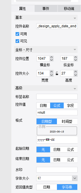

                            yzmknpQp2068966(提问者)   回复 snrtuemc
                           - 没有设置值,直接查询的
                            snrtuemc   回复 yzmknpQp2068966(提问者)
                           - 如果你设置=null,改成${if(len(plot_design_apply_date_end)=0||plot_design_apply_date_end='null',""," AND  ND.DESIGN_APPLY_DATE   <= date '"+plot_design_apply_date_end+"' ")}
                           - 不行
