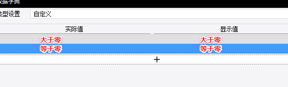

设置“拣货量”为下拉框控件,控件选项为大于0,等于0进行查询筛选,应如何操作?sql语句应如何更改啊

${IF(JHL='大于零'," and 拣货量>0"," and 拣货量=0")}
