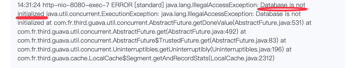

You've assigned more memory to the on-heap than the VM can sustain, please adjust your -Xmx setting accordingly
15:26:36 localhost-startStop-1 ERROR [standard]  Database is not initialized
数据库没初始化成功
在catalina.sh 下面配置了
JAVA_OPTS='-Xms2048m -Xmx4096m -XX:PermSize=256m -XX:MaxPermSize=512m'
成功登录

  • 啊嘞嘞 啊嘞嘞(提问者) 回复 luojian0323 14:31:24 http-nio-8080-exec-7 ERROR [standard] java.lang.IllegalAccessException: Database is not initialized java.util.concurrent.ExecutionException: java.lang.IllegalAccessException: Database is not initialized at com.fr.third.guava.util.concurrent.AbstractFuture.getDoneValue(AbstractFuture.java:531) at com.fr.third.guava.util.concurrent.AbstractFuture.get(AbstractFuture.java:492) at com.fr.third.guava.util.concurrent.AbstractFuture$TrustedFuture.get(AbstractFuture.java:83) at com.fr.third.guava.util.concurrent.Uninterruptibles.getUninterruptibly(Uninterruptibles.java:196) at com.fr.third.guava.cache.LocalCache$Segment.getAndRecordStats(LocalCache.java:2312)

FineDb数据库未正常初始化;解决方案:按照截图,找到「db.lck」文件,删掉即可!
