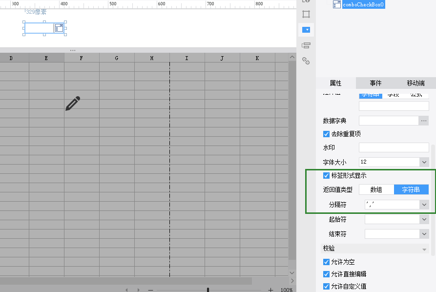

sql中是写的in吗,分隔符是否进行了修改?

我猜你的SQL写错了
请把SQL贴出来,以及复选框改成如下

${if(len(jidu) == 0,"","and quarter in ('" + replace(jidu,",","','") + "')")}
